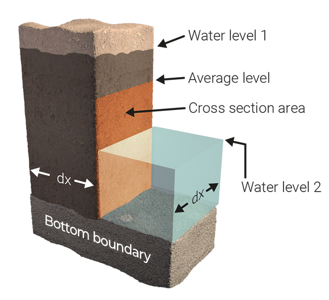

The assumption is made that ground is bound vertically by the surface of the terrain at the top and by an impenetrable layer at the bottom. The distance between the surface and the impenetrable layer, and thus the effective height of the ground, is equal to ground bottom distance. In other words, the impenetrable ground layer is assumed to be a set distance below the surface. The distance is uniform across the entire project area, and thus the impenetrable follows the profile of the surface.
The fraction of water the ground can store per volume is defined with the WATER_STORAGE_PERCENTAGE attribute of the ground layer terrain.
The ground layer is modeled using two layers: the unsaturated zone and the saturated zone. The saturated zone is the region of the ground where the soil is fully saturated with water. The unsaturated zone is the region of the ground located directly above the saturated zone. This region can also contain water, but the amount contained is always less than the maximum storage fraction. Water in the unsaturated zone is assumed to be uniformly distributed across the entire height of the zone.
The edge between the unsaturated and saturated zone is defined as the groundwater level, also known as the watertable.
The groundwater table is the height of the top of the saturated zone, relative to datum. The amount of water in the saturated zone is determined with the datum height of the groundwater table, the datum height of the surface, the ground bottom distance and the ground terrain's WATER_STORAGE_PERCENTAGE.
