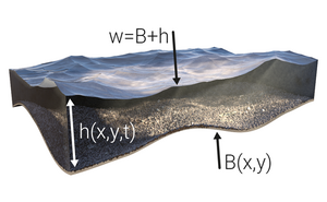

Fig. 1. For each grid cell:
B = bottom elevation
h = water depth
w = water surface elevation

This scheme deviates from the original Saint-Venant equations in that it approaches the system in terms of water surface elevation (w = h + B) and flux (hu and hv), instead of just the water depth (h). The conceptual image in Fig. 1 aims to clarify on the various terms in the model equations. This method relies on a continuous piecewise linear approximation of the surface, which is further explained on this page.
