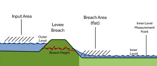

Side View of a Breach with a height, a Breach input area (Water Overlay) with a water level, a breach as an area where the water is released when it conceptually passes the breach and an inner level measurement point which calculates the downstream (inner) water level.

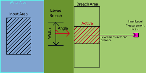

Top View of a Breach with a width and a direction, a point of measurement at a distance and an input area within a Water Area.

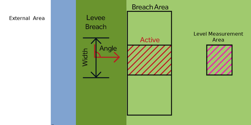

Side View of an alternative setup with an external water body defined by an external water and surface level from which the water originates, a breach as an area with a height, where the water is released when it conceptually passes the breach and a Breach level area which calculates the downstream (inner) water level.
Top View of an alternative setup with a Breach with a width and a direction, a Breach level area and an external area which is conceptually located outside the project area.

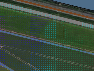

Water flowing through the breach will flow in the direction defined by the BREACH_ANGLE attribute, regardless of whether the water flowed onto the breach from elsewhere in the water model, or from the simulated external water body. When no BREACH_ANGLE is defined, water can flow in any direction. Adding this attribute with also convert the breach advection speed (m/s) into the 2D cell of the breach area. It is recommended to always use this attribute for optimal flow.

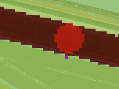

Flooding Overlay base type result showing the active an inactive part of the breach.
Flooding Overlay surface direction result showing the direction on the active and surrounding area around the breach.

- If a BREACH_WIDTH attribute is defined, the breach's polygon is intersected with a circle emanating from the center-point of the polygon. It is only in that intersection, called "active", that water will flow in from the input area. The radius of the circle defining the intersection will expand as the breach grows over time.

- With larger breaches the water level inside the breach area can become turbulent. Therefor the inner water level (used for breach growth) is measured at a distance defined in BREACH_MEASUREMENT_DISTANCE_M behind the breach area when an BREACH_ANGLE is provided.

- The elevation model covered by the entire breach area is lowered to at least the minimum height defined by its BREACH HEIGHT attribute. This is to prevent the terrain height from interfering with the flow.
- When using breach growth the inner water level is computed from the average value in the active breach area. For optimal flow simulation it is therefor recommended to place the breach area just behind the levee on a flat space.

- The Base Types Result child overlay can be used to see which part of entire the breach area is considered "active". Breach growth can be seen when checking multiple timeframes.
