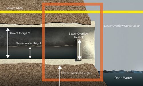

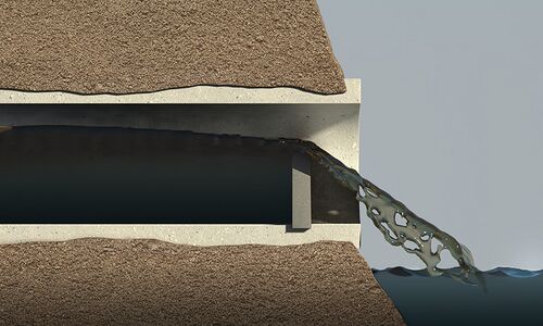

Water can flow from a sewer back onto the surface via a Sewer overflow. The location of the sewer overflow marks the exit at which water flows out of the sewer. The (maximum) speed at which this water flows is determined by the SEWER_OVERFLOW_SPEED.
For sewer overflow to occur, two criteria have to be met:
  • The amount of water in the sewer relative to the sewer's storage capacity as defined by the sewer area's SEWER_STORAGE attribute must exceed the SEWER_OVERFLOW_THRESHOLD.
  • The water level in the sewer must exceed the water level at the location of the server overflow.
The water level of the sewer is the sum of the water height in the sewer and the SEWER_OVERFLOW attribute of the sewer overflow, which defines the height at which it is situated. So conceptually, the height is the sewer is directly related to the sewer overflow height.
  • Schematic overview of a sewer overflow.
  • Schematic overview of water overflowing from a sewer.
