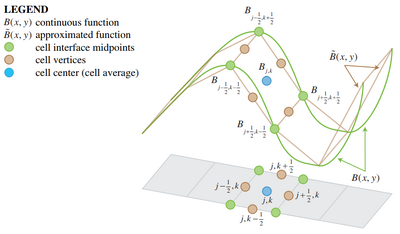

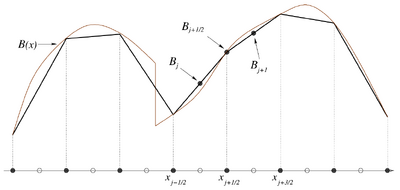

  • Reconstruction: No matter which option is configured for the elevation of a water overlay, it still will be reconstructed according to the requirements of the algorithm. Calculated building heights (to some extend) are also included in this reconstruction.
