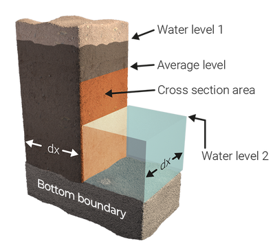

Two adjacent cells, where ground water level of cell 1 is larger than cell 2.
The flow between the two cells is calculated as:
Δwt=w1,tw2,t
Bbb=max(B1db,1,B2db,2)
Ac,t=Δx(wt¯Bbb)
K=min(K1,K2)
VK,t=ΔwKAc,tΔxΔt
where:
wn,t = The ground water level of cell n at time t.
Bc = the datum height of the surface of cell c, set by the elevation or a Terrain elevation prequel.
db,c = The ground bottom distance of the cell c, defined by a Bottom distance prequel or a general GROUND_BOTTOM_DISTANCE_M of the Water Overlay.
Bbb = the datum height of the bottom boundary at the edge of interaction between the two cells.
Kn = The hydraulic conductivity of the cell, defined in HYDRAULIC_CONDUCTIVITY_MD of the ground terrain.
Ac,t = Area of conductance at time t.
Δw = Ground water level difference at time t.
Δt = Computational timestep in seconds.
Δx = Size of grid cell.
wt¯ = Averaged ground water level at time t, based on water levels in ground, WATER_STORAGE_PERCENTAGE and potentially the surface water level, when the ground is filled to the top.
VK,t = The amount of water to be transported at time t between one cell and the other.
