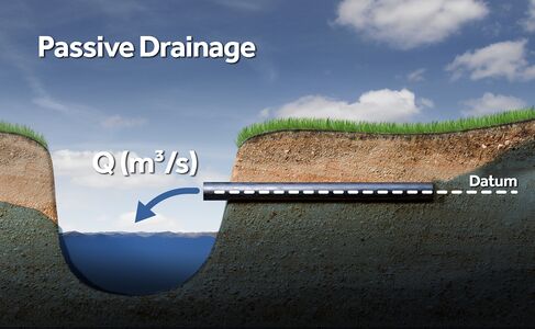

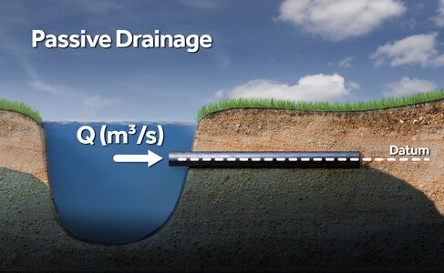

Passive Drainage
A passive drainage lets water flow from the drainage pipes into the waterway when it has a lower level. In case of a higher water level in the waterway the water flow from the waterway into the drainage pipes.
- Note: A passive drain must always has a positive Drainage Q value.
