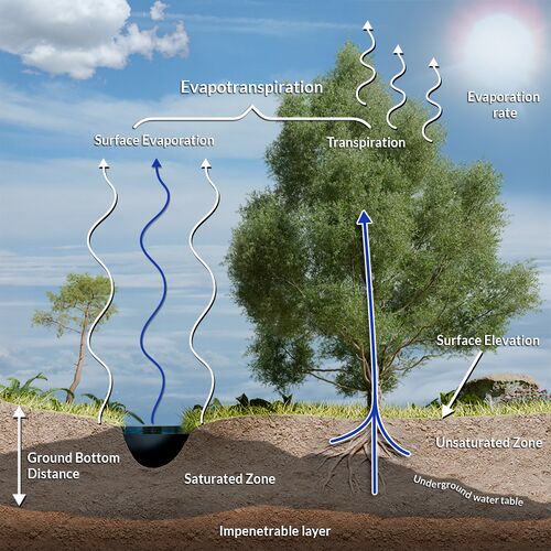

The combined processes through which water is transferred to the atmosphere from open water and vegetation that make up the surface cells. Two types of are implemented:
- Evaporation: the movement of water directly to the air from sources such as the soil and water bodies. It can be affected by factors including heat, humidity, solar radiation and wind speed.
- Transpiration: the movement of water from root systems, through a plant, and exit into the air as water vapor.

Surface Evaporation
Water situated on the surface is conceptually able to evaporate. The amount is based on the weather's evaporation rate and the overlay's SURFACE_WATER_EVAPORATION_FACTOR. The product of these two attributes results in the actual rate of evaporation. The water in each individual cell at the surface is then subject to the calculated rate of evaporation, according to the surface evaporation formula.
Ground Transpiration
Water can transpire from the ground if the cell's surface meets either of the following criteria:

Feddes factor
Conceptually, water can transpirate from the ground via crop, tree and plant foliage. Their roots can draw water from the unsaturated and saturated zones in the ground, when these reach deep enough and the transpiration factor is non-zero. Water is drawn from the ground and transpirated into the air, effectively removing it from the hydrological model. Water for transpiration can only be drawn from sections of the ground which are within reach of the roots, as defined by the root depth. Using the multiple root depth values, it is also possible to define a threshold at which the roots are unable, or less able, to extract ground water, due to oxygen stress. It such case up to 4 root depth values have to be provided, from deepest to less deep.
Seasonal factor
The ground evaporation can be configured directly by changing the terrain type's WATER_TRANSPIRATION_FACTOR and building 's WATER_TRANSPIRATION_FACTOR. If these attributes are set to 0, no ground evaporation will take place. This attribute can also be set as 4 distinct values, one for each growth season. This allows for more transpiration during a crops growth season and less during the winter.
Varying transpiration rate
Similar to the surface evaporation, the rate of ground transpiration is also determined by the weather definition's evaporation rate. Multiplying the weather's evaporation rate and the transpiration factor of the building or terrain (as applicable) gives the actual transpiration rate for the ground.
Ground transpiration first draws water from the unsaturated region and then from the saturated region. If, according to the calculated transpiration rate, a sufficient amount of water can transpirate from the unsaturated zone, no water will transpirate from the saturated zone. Otherwise, all water in the unsaturated zone which is in reach of the roots of the building or terrain (as applicable) is transpirated, and the remainder of the amount of water which should transpirate according to the transpiration rate is transpirated from the saturated zone. The sum of transpiration in the unsaturated zone and the saturated zone will never exceed the calculated transpiration rate.
