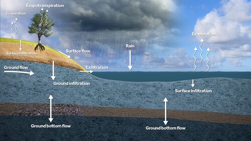

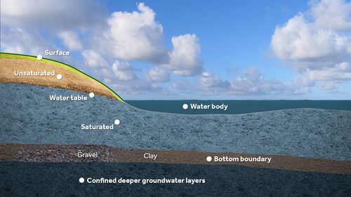

Supported layers in rain, flooding and ground water calculations.
Supported flows between the layers in rain, flooding and ground water calculations.
