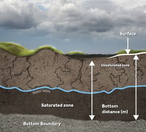

Water can infiltrate from the unsaturated zone to the saturated zone.
The infiltration from the unsaturated zone to the saturated zone is calculated per cell.
First the height of the unsaturated zone is calculated.
du=Bcwg
Then the ratio of water amount to unsaturated height is calculated.
r=Δwu/du
Then we calculate the distance of the unsaturated zone which can infiltrate.
di=min(du,Δtfi,tIg)
Finally, we calculate the actual amount of water that infiltrates from the unsaturated zone to the saturated zone.
Δwi=dir
Where:
wg = The groundwater level, relative to datum.
Bc = the datum height of the surface of cell c, set by the elevation or a Terrain elevation prequel.
du = The height of the unsaturated zone.
Δwu = The amount of water in the unsaturated zone. The height of the water column if the equivalent amount of water was placed on the surface.
r = Ratio of water to height in the unsaturated zone.
Δt = Computational timestep in seconds.
fi,t = The interpolated infiltration factor at time t. Configured using INFILTRATION_FACTOR_S.
Ig = The GROUND_INFILTRATION_MD of the underground terrain type.
di = The height distance in the unsaturated zone which can be subject to infiltration to the saturated zone.
Δwi = The infiltration which takes place from the unsaturated zone to the saturated zone.
