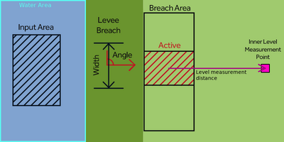

Breach with (internal) Input Area and a Measurement Point

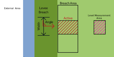

Breach with External Water Level and a Breach Level Area
  • The breach height Hb,t can be defined over time, by configuring the BREACH_HEIGHT as an attribute array.
  • The inner water level is to be measured not directly inside the breach area but a few meters away. By default 100m, this can be adjusted via the BREACH_MEASUREMENT_DISTANCE_M attribute. It can also be measured using a manual defined level area.
