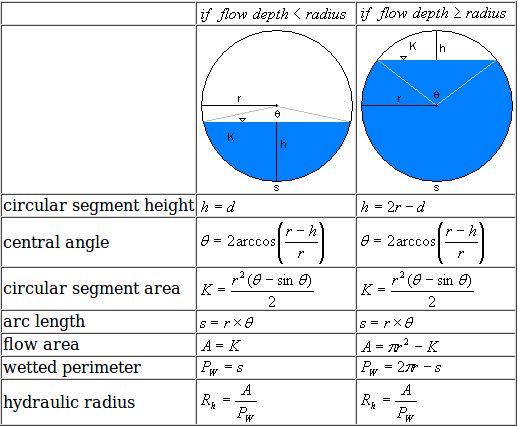

For circular culverts, the flow area A and the wetted perimeter Pw is calculated using the formula's in the image below.
Where the radius of the culvert:
r=D2
