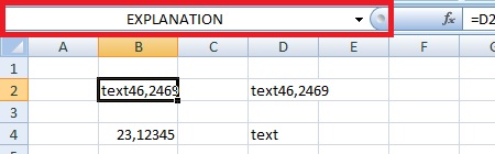

In this image the cell B2 is named "EXPLANATION". This serves as an output cell. For its content it refers to a different cell.
The most important part of the Excel file is the output. The Tygron Platform will detect each output cell, and calculate their contents. If those cells reference other cells, those other cells will be calculated as well. The Tygron Platform will continue this until the contents for all output cells are calculated. Each component which uses an Excel file for its calculation has one or more required output cells. The output can then be used during a session. Additional output cells are created when TQL update statements are added to the Excel.

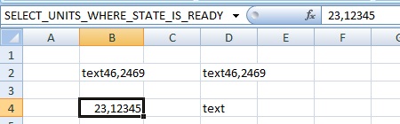

In this image the cell B4 is named "SELECT_UNITS_WHERE_STATE_IS_READY". This serves as an input cell. It has a value, which will be overwritten by the Tygron Platform.
Next to the output cells, the input cells are most important. You will generally want your Excel file to produce different outputs based on the current state of the project or session. Input cells are always defined using TQL. When the Excel file is uploaded and used by the Tygron Platform, the content of the input cells will be overwritten by the Tygron Platform with the proper, requested value.

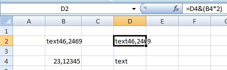

In this image the cell D2 contains a formula. It's not directly overwritten by the Tygron Platform, but the results change based on input from the Tygron Platform. It is referred to by an output cell, so this is a calculation cell.
In between, there are the calculation cells. It's likely you don't want to output the data from the Tygron Platform directly. Instead, you want to use it in some form of calculation, and display only the result, likely with some formatting. For example, you may not want to return the amount of green and the amount of houses, but the amount of green per house, rounded to a decimal or two, with some unit appended to it. Any cell, even empty cells, are deemed to be calculation cells if they are referenced by an output cell, because their contents are calculated (evaluated) to determine what the output will be.

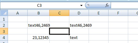

In this image the cell C3 is empty and unnamed, so it is not an input or output cell. It is also not referred to, so its an unreferenced cell.
Lastly there are unreferenced cells. These are cells which are not input cells, and are not referenced directly or indirectly by output cells. Empty cells, when referenced directly or indirectly by output cells, are evaluated, and thus seen as used. Unreferenced cells can contain values or even formulas, or even reference input cells. Unreferenced cells with formulas can be useful when creating or inspecting excel sheets, to provide insight in how the calculation works.

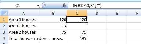

It is possible that, although you retrieve all elements which exist in the Tygron Platform, you only wish to perform calculations with a subset of them. . In these cases, Excel formulas can be used to determine which data should or should not be processed in your calculations. Especially functions which perform conditional sums work well for this purpose, or statements which multiply irrelevant data with "0".

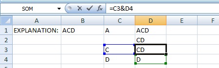

Each row's contents are composed of the data on that row, followed by whatever is composed on the next row.
Excel does not provide a dynamic solution for appending large amounts of text. However, there is a way to put text together from consecutive rows or columns. By creating a formula that appends the contents of the current row to the contents of the next row, data from all rows can be appended together, and thus placed in the explanation in one go.
Do note that using this technique makes it very easy to create a very deep chain of commands to process by the Tygron Platform. When combining many hundreds of rows, the Tygron Platform may indicate it was unable to process the entire file due to something called a "Stack overflow". Make sure you use this combining technique only for limited amounts of rows.
