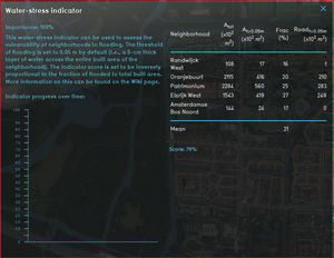

Indicator panel
Figure 1. Water-stress indicator panel (example use case).
By default the indicator panel (Fig. 1) displays the following information in the columns from left to right:
  • Name of the neighborhood
  • Total built area (m2)
  • Built area exceeding the inundation threshold (m2)
  • Ratio between the previous two parameters (%)
  • Road/street area exceeding the inundation threshold (m2)
Note: the rightmost column is nothing more than a narrowed-down version of the 3rd column, so its values can never turn out higher.

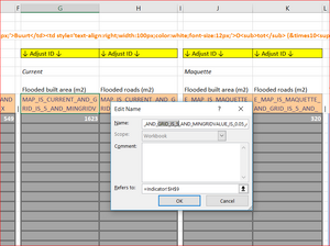

Edit the Excel file
Figure 2. The ID's in queries can be changed through the Name Manager.
In the Excel file the ID of the Rainfall Overlay needs to be changed in the TQL queries in cells G9, H9, J9 and K9.
Water stress (Indicator):
  1. Open the downloaded Excel spreadsheet.
  2. On the Formulas tab, in the Define Names group, click the Name Manager.
  3. Edit the 4 names containing GRID_IS_5 and change the ID to the correct number (Fig. 2).
  4. For clarity adjust the corresponding cell formulas accordingly.
  5. Save your changes and update the indicator file in your project.
