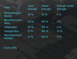

The indicator panel (see the image on the right) shows in a table per neighborhood:
  • The neighborhood name
  • If the neighborhood is cool enough
  • If the neighborhood is green enough
  • If there is enough water storage in the neighborhood

The calculation on if a neighborhood is cool enough is determined by calculating the ratio between areas with an average temperature deviation of +0.5 degrees and the total size of the built environment. If a neighborhood has enough green is calculated by comparing the amount of m² green space (terrain types grassland, open land and dunes) to the amount of m² total land. To reach a score of 100% on enough green, a neighborhood needs to consist of 20% green. This percentage can be changed in the Excel file of the indicator. If the neighborhood has enough water storage is calculated by comparing the amount of m² terrain with water storage to the amount of m² total land. To reach a score of 100% of enough water storage, an area needs to consist of 30% water. This percentage can also be changed in the Excel file.
Score
The score is represented a progress bar, with a scale from 0 to 100%. This is the average of the progress on how cool, how green the area is and how much water storage there is in the area. Determine if you want to calculate the absolute or relative score. The higher the score, the more climate adaptive the neighborhoods in the project are.
