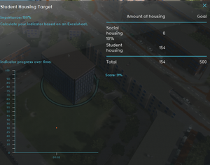

Indicator panel
The indicator panel shows the two different types of housing, the number of houses that are built in the neighborhood and the targets for the social housing and the total target.

Score
The score is represented in a progress bar, with a scale from 0 to 100%. Determine if you want to calculate the absolute or relative score.
