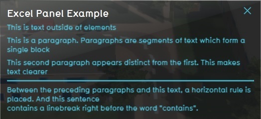

Text formatting
An example display with some basic text styling.
For basic text styling, a number of elements exist.
Paragraph: <p>
The paragraph element <p>paragraph</p> is used to define a segment of text which is supposed to appear as a paragraph of text. A paragraph is slightly indented, and is surrounded by a bit of empty space. This automatically separates consecutive paragraphs, for easy of reading.
Horizontal rule: <hr>
The horizontal rule element <hr> inserts a horizontal line into the layout. Horizontal lines are useful for separating segments of information.
Linebreak: <br>
The linebreak element <br> indicates that in this point of the layout, the line ends. Anything that comes after should appear on a new line.

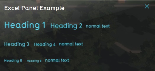

Headings: <h1>, <h2>, etc
An example display with the available headings.
The heading elements <h1>heading</h1>, <h2>heading</h2>, (continuing through to <h6>heading</h6>) are generally used for titles. The lower the number, the larger and more prominent the title.

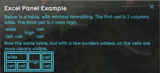

Colspan and Rowspan
When a cell has to span multiple rows or columns, the colspan and rowspan attributes can be used.
<table>
<tr> <td colspan=2> A </td> </tr>
<tr> <td> C </td> <td> D </td> </tr>
</table>
would result in
  A
  C     D

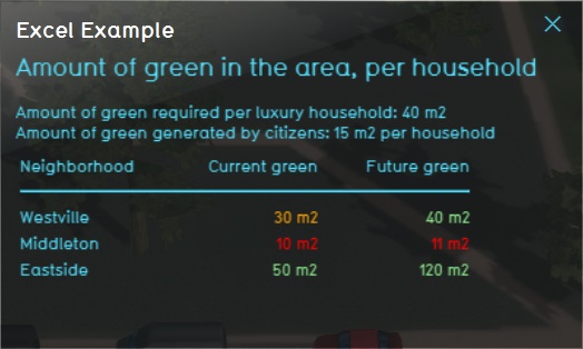

HTML table
The HTML example will appear like this in the Tygron Platform. There may be slight differences when it is displayed in a browser.
The following table layout can be created using HTML:
Amount of green in the area, per household
Amount of green required per luxury household: 40 m2
Amount of green generated by citizens: 15 m2 per household
NeighborhoodCurrent greenFuture green
Westville30 m240 m2
Middleton10 m211 m2
Eastside50 m2120 m2
The following is important to note:
  • The display consists of a header, a paragraph with 2 sentences separated by a linebreak, and a table.
  • The header has a row which serves as a header, followed by a row with a horizontal rule to separate it from the rest of the table. The rest of the table contains the actual data of the table.
  • The values in the table are colored, to create an intuitive overview of where the values are good or bad. This coloring is set on a per-cell basis.
<h2>Amount of green in the area, per household</h2>
<p>Amount of green required per luxury household: 40 m2<br>Amount of green generated by citizens: 15 m2 per household</p>
<table>
  <tr>
    <td style='text-align:left;width:100px;'>Neighborhood</td>
    <td style='text-align:right;width:100px;'>Current green</td>
    <td style='text-align:right;width:100px;'>Future green</td>
    </tr>
  <tr>
    <td colspan=3><hr></td>
  </tr>
  <tr>
    <td style='text-align:left;'>Westville</td>
    <td style='text-align:right;color:orange;'>30 m2</td>
    <td style='text-align:right;color:lightgreen;'>40 m2</td>
  </tr>
  <tr>
    <td style='text-align:left;'>Middleton</td>
    <td style='text-align:right;color:#ff0000;'>10 m2</td>
    <td style='text-align:right;color:#ff0000;'>11 m2</td>
  </tr>
  <tr>
    <td style='text-align:left;'>Eastside</td>
    <td style='text-align:right;color:lightgreen;'>50 m2</td>
    <td style='text-align:right;color:lightgreen;'>120 m2</td>
  </tr>
</table>

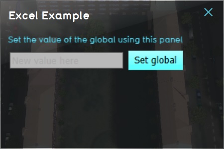

Form to set 1 global
A form to change a single Global in a project can be created in HTML.
The example is for a form that allows an end-user to change the value of a Global with an ID of 0, to some value which the end-user can set.
Most of the form is hidden, so inspecting the html code is recommended, but the following is important to note:
  • The form itself defines an action to take. In this example specifically, the endpoint "global_set_value" will set the value of a global.
  • The form includes 2 inputs, named 0 and 1. This is because the "global_set_value" requires 2 pieces of data: the ID of the global to modify, and the value to set the global to.
  • The first of those inputs (with name 0) is hidden, so that an end-user cannot change the ID to an incorrect or invalid ID. This means you need to find and set the ID of the global you wish to have the end-user change. I.e., changing it to <input type='hidden' name='0' value='3' /> will mean the form changes the Global with ID 3.
  • The second input is set to only allow numbers to be entered.
  • A redirect input is included, so that after the form is submitted, the software sends the user back to the panel. The address of the panel is set at the end of the example using javascript.
  • The only actually visible elements are the leading text, the input field for the (new) value of the global, and the submit button.
<div>
	<p>Set the value of the global using this panel</p>
	<form action='$SESSION/event/LogicEventType/global_set_value/?token=$TOKEN' method='post'>
		<input type='hidden' name='redirect' class='insertThisUrl' value='#'>
		<input type='hidden' name='0' value='0' />
		<input type='number' name='1' value='' placeholder='New value here'/>
		<input type='submit' value='Set global'/>
	</form>
	<script>
		$('.insertThisUrl').val(window.location.href);
	</script>
</div>

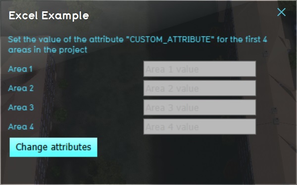

Form to set attribute for multiple areas
A form to set or change the values of a "CUSTOM_ATTRIBUTE" Attribute of multiple Areas in a project can be created in HTML, enhanced with javascript to transfer the entered data into a format compatible with the Tygron Platform's API.
The example allows for an end-user to input a desired value for 4 different Areas.
  • The form itself defines an action to take. In this example specifically, the endpoint "areas_set_attributes" will set attribute values for multiple areas. This endpoint expects 3 parameters: an Area specified by ID, the name of the Attribute to set, and the value to set that Area's Attribute to. This endpoint can also process lists of each of those parameters, so multiple Areas and/or multiple values can be modified.
  • The actual value input fields are actually not part of the HTML form itself. Instead, because the data needs to be structured in a particular way when sending parameters for multiple changes, a small script will run to take all values the end-user has filled in and add it to the form when the end-user is ready.
  • There are multiple inputs of type "number", which the end-user can fill in. There is one input field per Area which the end-user can set. The input fields have some additional data to specify a specific Area by ID, and to specify an Attribute to set.
  • The "submit" button is part of the form, so that when the user clicks it the form is sent.
  • The "onclick" attribute of the button indicates that when the user clicks the button (but before the form is sent), a javascript function is triggered which reads all input fields adds the data the end-user has entered into the form.
<div>
	<p>Set the value of the attribute "CUSTOM_ATTRIBUTE" for the first 4 areas in the project</p>
	<div class='inputForm'>
		<span style='display:inline-block;width:180px;'>Area 1</span><input type='number' data-area='0' data-attribute='CUSTOM_ATTRIBUTE' value='' placeholder='Area 1 value'><br>
		<span style='display:inline-block;width:180px;'>Area 2</span><input type='number' data-area='1' data-attribute='CUSTOM_ATTRIBUTE' value='' placeholder='Area 2 value'><br>
		<span style='display:inline-block;width:180px;'>Area 3</span><input type='number' data-area='2' data-attribute='CUSTOM_ATTRIBUTE' value='' placeholder='Area 3 value'><br>
		<span style='display:inline-block;width:180px;'>Area 4</span><input type='number' data-area='3' data-attribute='CUSTOM_ATTRIBUTE' value='' placeholder='Area 4 value'><br>
	</div>
	<form class='submitForm' action="$SESSION/event/LogicEventType/areas_set_attributes/?token=$TOKEN" method="post">
		<input type='hidden' name='0' value=''>
		<input type='hidden' name='1' value=''>
		<input type='hidden' name='2' value=''>
		<input type='submit' onclick='fillForm()' value='Change attributes' />
	</form>
	<script>
		fillForm = function() {
			var ids = [];
			var attributes = [];
			var values = [];
			for (var input of $('.inputForm').find('input') ) {
				if ( $(input).val() !== '' ) {
					ids.push( $(input).attr('data-area') );
					attributes.push( $(input).attr('data-attribute') );
					values.push( $(input).val() );
			if (ids.length>0) {
				$('.submitForm').find('[name=\'0\']').val(JSON.stringify(ids));
				$('.submitForm').find('[name=\'1\']').val(JSON.stringify(attributes));
				$('.submitForm').find('[name=\'2\']').val(JSON.stringify(values));
			} else {
				return false;
	</script>
</div>
To use this example effectively, it is recommended to create an Excel which outputs the HTML presented here, and then replaces the following by the desired information:
