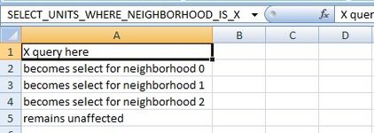

X query (Excel)
Example of what will happen with an X query with 3 neighborhoods.
For use-cases in which an Excel is used to aggregate data, for example to compute specific scores per Neighborhood for display in an Indicator, it is not desirable to create individual TQL queries for each piece of data that needs to be retrieved. Rather than stating each individual Neighborhood for which to retrieve data, an X query can be used to indicate that, across multiple rows, the data of all Neighborhoods should be retrieved, regardless of how many or how few that may be.
Where a normal query would be of the following form:
SELECT_LANDSIZE_WHERE_NEIGHBORHOOD_IS_1
Multiple such queries would be required to retrieve the sizes of all Neighborhoods. Instead, it is possible to create an X query of the following form:
SELECT_LANDSIZE_WHERE_NEIGHBORHOOD_IS_X
The Tygron Platform will interpret this as an instruction to create additional, specific queries in the excel, one for each Neighborhood in the Project.
An X query can still consist of multiple clauses, including clauses referring to specific Items.
SELECT_LANDSIZE_WHERE_NEIGHBORHOOD_IS_X_AND_STAKEHOLDER_IS_0_AND_TERRAIN_WITH_ATTRIBUTE_IS_WATER

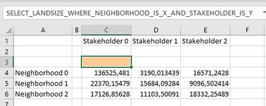

XY queries
The orange cell is named with an XY query for Neighborhoods and Stakeholders. The resulting matrix shows how much of which Neighborhood is owned by which Stakeholder, in a Project with 3 of each.
XY queries allow queries to be generated in 2 dimensions in the Excel, creating a matrix of queries to retrieve values with. The queries will be generated in the downward direction with the X being replaced by applicable ID's for that clause, and to the right with the Y being replaced by applicable IDs for that clause. This means that on each row, queries exist in which the X has been replaced by the same values but the Y values differ, and that in each column the Y has been replaced by the same values by the X values differ.
As with X queries without a Y, the first generated query will be generated for the cell directly below the cell containing the XY query. The first query is not also shifted to the right by the presence of a Y.
A maximum of 16.000 queries can be generated in the horizontal direction from a single XY query.
An example of a XY query can be:
SELECT_LOTSIZE_WHERE_NEIGHBORHOOD_IS_X_AND_STAKEHOLDER_IS_Y

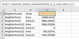

Multi X queries
The generated queries go through all Areas for one Neighborhood first, then for the next Neighborhood, until all combinations have been made. The output is the amount of overlap between each combination of specific Neighborhood and specific Area.
It is possible to have multiple clauses with an X (multiple queries with a Y) in the same query. In these situations, both X's are expanded in the same direction. Both (or all) clauses resolves to their first applicable ID. For the next generated query, only one of the generated queries resolves to the next ID, while the other(s) remain set to their first ID. This continues until the all applicable IDs of that clause have been used. Then, the other clause's ID is advanced by one, and the first clause starts at its first ID again, progressing until all its applicable IDs are exhausted.
For virtually all use-cases, it is more convenient to use an XY query than a multi X query, as it makes it easier to parse exactly which values have which meaning, and to structure the data for further calculations.

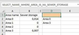

XA queries
The orange cell is named with an XA query for Areas with SEWER_STORAGE. The first columns retrieve all Area names and their SEWER_STORAGE values (if any). The XA query returns only the names of the Areas with that Attribute.
The X syntax can be expanded to be more selective on which Items to generate queries for, using the XA syntax. For example, rather than generating queries for all Areas in a Project, which may all serve a wildly different purpose, it is possible to retrieve only the Areas with a specific Attribute.
A query which would retrieve the names only of Areas which have a SEWER_STOARGE Attribute, marking them as Sewer Areas for use with the Water Overlay, could be constructed as follows:
SELECT_NAME_WHERE_AREA_IS_XA_SEWER_STORAGE
This will generate only queries for Areas which have an Attribute SEWER_STORAGE, in which "XA_SEWER_STORAGE" is in its entirety replaced by the relevant Area's ID. IDs of Areas which do not have the specified Attribute, or of which the Attribute's value is 0, are skipped in the same way that the IDs of deleted Items are skipped.

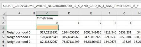

Index and timeframe
The orange cell is named with an XY query for calculated volumes of water per Neighborhood and per timeframe.
For most cases, the X applies to a replacement value for an Item's ID. Two clauses form an exception to this: the INDEX clause and the TIMEFRAME clause.
The following queries are allowed, and will be expanded according to the same rules as other X queries:
SELECT_ATTRIBUTE_WHERE_NAME_IS_BREACH_HEIGHT_AND_AREA_IS_0_AND_INDEX_IS_X
This will result in multiple queries, each retrieving a sequential value from the array of values of the BREACH_HEIGHT Attribute, of the Area with ID 0.
SELECT_GRIDAVG_WHERE_GRID_IS_3_AND_TIMEFRAME_IS_X
This will result in multiple queries, each retrieving the average result of a grid calculation for the entire map, for sequential timeframes.
This functionality is commonly combined with the ability to use an additional Y clause to retrieve a matrix of values for multiple Items.
