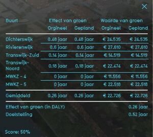

The indicator panel shows the following information:
  • The name of the neighborhood
  • The effect of green in that neighborhood in the current situation
  • The effect of green in that neighborhood in the future (planned) situation
  • The value of green in that neighborhood in the current situation
  • The value of green in that neighborhood in the future (planned) situation
  • The averages for the effect of green and value of green in the current and planned situation
  • The effect of green (in DALY) for the whole project area
  • The goal (this is calculated by assuming the effect of green in Daly for the whole project area in the current situation is 50%. Double this amount is then 100%)
