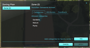

If, during a session, an action does not conform to the zoning plan, a permission popup will appear, indicating a conflict with the zoning plan. In order to resolve the conflict with the zoning plan, either:
  • the action has to be adjusted.
  • the zoning plan is changed by the permitter.
  • the action has to be reverted.

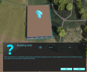

An example of a Stakeholder placing a new Sports Center in a Zone that does not allow it:
