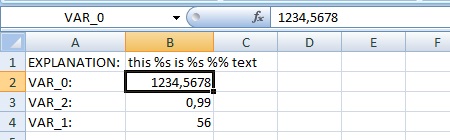

In this example, the output of the Excel will read "this 1.234,568 is 56 % text". There are not enough places to insert all VARs, so VAR_2 is ignored. However, it is calculated.

To define one or multiple VAR cells, name a cell VAR_N, where N is a sequential number starting at 0 (so VAR_0, VAR_1, VAR_2, etc). To indicate where in the explanation the VARs should be inserted, you can create an insertion point by writing "%s" in the explanation. The Tygron Platform will insert each VAR, in order, into these places in the text.

Also note that the Tygron Platform will ignore additional VAR cells if there are not enough insertion points (although the cells will still be evaluated), but that the Tygron Platform will be unable to display the explanation properly if there are too many insertion points. If that is the case, an error will be displayed instead of the proper explanation.
Lastly, when using VARs, the Tygron Platform will check the output text for any "%" symbols. If you wish to use a literal "%" in your explanation while using VARs, you can instruct the Tygron Platform to leave it as is by writing "%%" instead.
