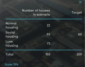

Indicator panel
The indicator panel shows the three different types of housing, the number of houses that are built in the neighborhood and the targets for the social housing and the total target.
