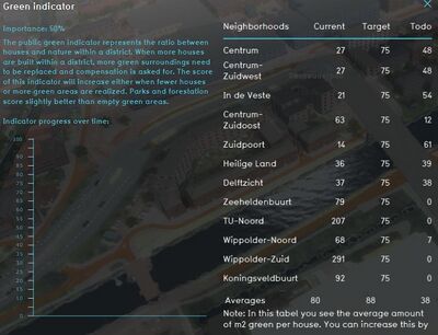

Indicator panel
The indicator panel shows per neighborhood:
  • the neighborhood name
  • the current amount of green (m2) in the neighborhood
  • the target amount of green (m2) for the neighborhood
  • how much green in (m2) per neighborhood should be build
