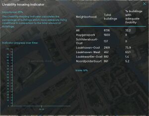

The indicator panel shows the present neighborhoods in the area, the total amount of houses in each neighborhood and the percentage of houses with adequate livability conditions.
