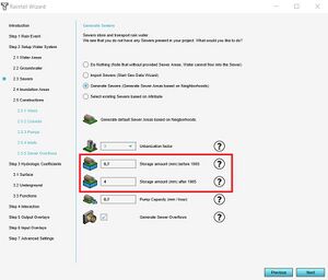

- Sewers don't have a default storage amount, but when generating them automatically in the water overlay wizard a recommended sewer storage is provided. You can change these amounts if desired.
- In the generate sewers step in the wizard, a difference is made between a sewer storage amount before 1965 and after 1965. An average construction year is calculated per neighborhood which will determine in which category the to be created sewer areas fall.
