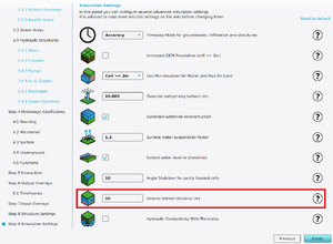

Ground bottom distance m (Water Overlay)

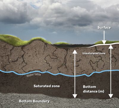

GROUND_BOTTOM_DISTANCE_M | m | 0 to 10000 | Assumed distance under the surface terrain where the bottom boundary is situated. | 10 |
The groundwater level cannot go below this depth, relative to the surface. The maximum amount of water that can be stored underground is equal to this attribute multiplied by the local terrain's WATER_STORAGE_PERCENTAGE.
- A varying ground bottom distance can be configured when using a Bottom distance prequel.
