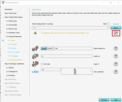

Feedback
In the Water Overlay Wizard you can encounter several of the components highlighted yellow (warning) or red (error). This feedback is provided to help you configure the modelled water system to make it fully functional in the Tygron Platform and provide information about the configured settings and imported data. Any errors in the imported data for example will be highlighted. When selecting a step which is highligthed yellow or red, the drop-down menu will automatically place the warnings and errors at the top of the menu. When selecting one of these from the menu, feedback about the warning or error is displayed in the wizard. To solve these issues, possible fixes are proposed which can be automatically applied when accepted. The possible fixes are depicted with the tool icon. By clicking on this icon, the fix is proposed and can be applied.
See also How to apply fixes for multiple components in the Water Overlay Wizard.
Warning in the wizard
