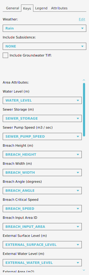

The Water Overlay's long list of configurable Keys
The Keys an Overlay's calculation model uses and their configured values can be found under the tab Keys in the right panel.
