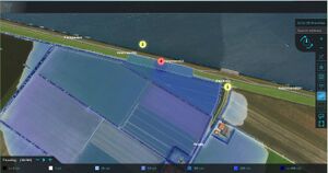

A levee exists between the large lake to the north, and the farms and small groups of buildings to the south. On this levee, an "Area" has been drawn to represent the point of a breach. The properties of the breach are defined as attributes of the drawn Area. The breach starts small, but as part of the simulation, it will grow over time, allowing more water to flood in.
Clicking on the popup will show the Base Types overlay, which shows what features are present in the project area for the purpose of the flooding simulation.

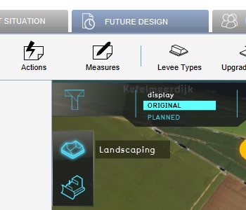

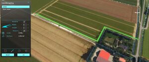

Switch to the "Future design" tab, and then in the viewer interface the Action Menu will appear. Open the menu with "Landscaping" options, and select the "Levee" action. You are now able to draw a line which will be the site of a new levee. Draw one or more lines in a protective formation near one of the farms which is affected by the flood. When you have made the selection, select "Ok". This will create a new levee, which will block water flowing across the land.
After making the change, the flooding overlay will be recalculated, and the new results will indicate how water would act with the new levee. In all probability, the levee will not stop all the water permanently, but may serve to delay the water, granting more time for people to prepare or evacuate. At the top of the interface, in the Top bar, find the "display" option, and select the "Original" mode. This will display the results of the original calculation. Activate the flooding overlay and find the moment in time where the water surrounds the farm. Now switch the display mode to "Planned". This will show the results of the overlay based on the effects of the levee. If the levee is effective, the new results will show the farm less (or not yet) affected by the water at the same moment in time. Forward the overlay result slightly to see the new moment where the farm is affected. All time in between is evacuation time gained by creating a levee in well-conceived location.
