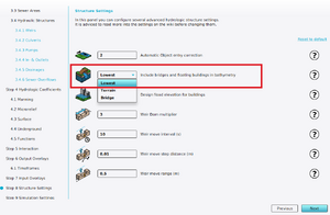

Bridge elevation (Water Overlay)
BRIDGE_ELEVATION | nominal | 0 to 2 | Specifies the mode by which bridges are include in the elevation model, used for the water calculations. | Lowest |
The water model uses an elevation model for the surface flow calculations. This setting defines how to include bridges in this elevation model:
| 0. | Lowest: The lowest elevation point from the terrain elevation (DTM) below bridge is used, when the terrain is water. Otherwise the behavior is similar to Terrain. |
| 1. | Terrain: Under bridges, the terrain elevation (DTM) is used, otherwise the limited surface elevation (DSM) is used. Water can flow under the bridge according to the terrain elevation. |
| 2. | Bridge : Use bridge deck as elevation. Bridges and floating buildings are included in the DEM, blocking water flow. |

- When using Bridge mode, it is still possible to model the flow from one side of a bridge to the other by using a Culvert.
- The surface elevation (DSM) always limits the height of the buildings to the design flood elevation.
