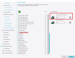

Impact flood threshold m (Water Overlay)

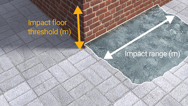

IMPACT_FLOOD_THRESHOLD_M | m | The amount of water a Building must experience before it is considered impacted by water. | 0,1 |
Water must reach this height either on one of the cells the Building is on, or on one of the cells adjacent to it. With the impact range m attribute the width of the water along the facade can be adjusted. This is used to compute the Impacted buildings result type.

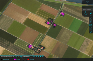

Water Overlay with a configured flood threshold of 0.1m and a impact range of 3m.

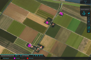

Water Overlay with a configured flood threshold of 0.5m and a impact range of 3m.

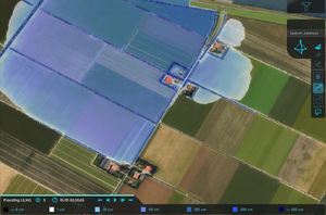

Surface last value result overlay of a 30 minute flood caused by a Breach.
