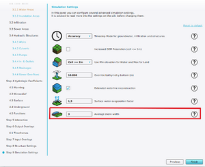

Avg shore width m (Water Overlay)
AVG_SHORE_WIDTH_M | m | 0 to 10000 grid cells | With the surface water mode set to Grid Averaging, identified water average areas can be extended to include nearby shorelines within the configured distance. | 3 |
Water polygons supplied by Geo data often do not include the shorelines around it, which could still contain water due to overflowing. Additionally, shorelines are important for the interaction between ground water and water ways.

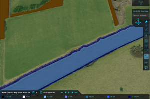

Water Overlay set to Grid Averaging Waterways and a configured average shore width of 3m.
Water Overlay set to Grid Averaging Waterways and a configured average shore width of 10m.
Difference in water level.
