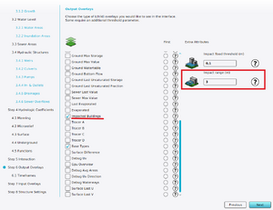

Impact range m (Water Overlay)
IMPACT_RANGE_M | m | the width in meters of the water next to or against the building that have to be flooded before the building is considered impacted by water. | 3 |
This attribute can tune the amount of cells that has to be flooded before the building is considered impacted. For example a value of 0 means the buildings is always impacted, a value of 1 means at least 1m of cells touching the building needs to be flooded and so on. With the Impact flood threshold m attribute the height of the water can be adjusted.

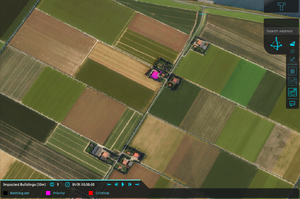

Water Overlay with a configured flood threshold of 0.5m and a impact range of 3m.

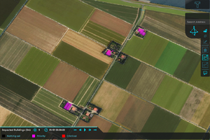

Water Overlay with a configured range m threshold of 0.5m and a impact range of 30m.

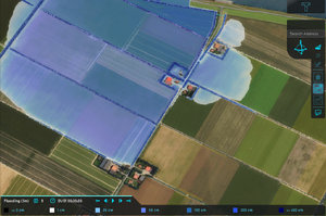

Surface last value result overlay of a 30 minute flood caused by a Breach.
