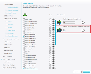

Ground watertable with surface (Water Overlay)
GROUND_WATERTABLE_WITH_SURFACE | boolean | Whether the ground watertable result type should also include the surface water level, when the groundwater levels are close to the surface. | True |
Measurement of a waterway for a water table result of a Water Overlay set to include the surface for the ground watertable.
Measurement of a waterway for a water table result of Water Overlay set to exclude the surface for the ground watertable.
