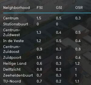

Indicator panel
The indicator panel shows per neighborhood:
  • The neighborhood name
  • FSI score
  • GSI score
  • OSR score
Each of these indices is also added as an attribute to the neighborhoods. These attributes can then be used for visualizing the scores in a map. See the additional configurations for the steps.
