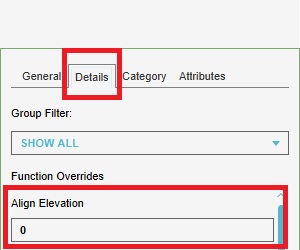

Align elevation (Function Value)
| Function value | Attribute | Unit | Per category | Range | Description |
| Align Elevation | ALIGN_ELEVATION | Integer | No | 0 to 2 | Attribute that determines whether a Building is aligned relative to the elevation model (in case of an uneven surface), flat on the ground, or floating. |
The possible values for the attribute are:
0 = flat on the ground
1 = floating
2 = aligned to the elevation model.
