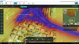

The Traffic Noise Overlay is a Grid Overlay which computes the amount of noise in dB(A) for any given location in the project. The calculation takes into account traffic intensities and a number of environmental- and computation parameters to compute the noise impact. It also takes into account Buildings and terrain features which would block the transmission of noise.
The Overlay only computes noise from traffic. Although a background noise level can be configured, other sources of noise (such as windmills, air traffic, or factories) are explicitly excluded.
