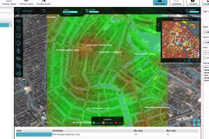

The Livability Overlay is a grid overlay which displays the average livability in different colors for the project area, indicating good, average and bad livability. Each building and each terrain has a default specified livability effect, based on research. The average value of a location is the combined livability effect values of the surrounding functions in a 200m radius.
The livability overlay and its metric are based on the VROM commissioned "Leefbaarometer".[1]
Legend
  • Green (Good): Indicates a good livability, compared to the surroundings.
  • Orange (Average): Indicates an average livability, compared to the surroundings.
  • Color: Red (Bad): Indicates a bad livability, compared to the surroundings.

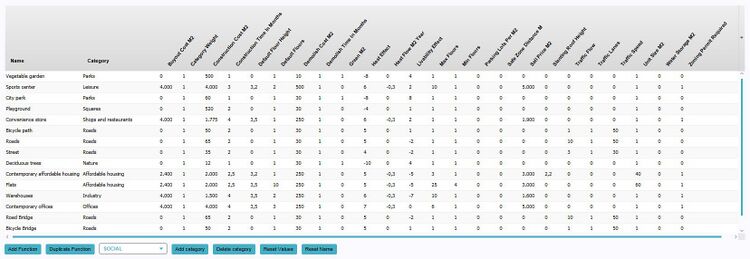

Changing function values to change effects on the Livability
Main article: Changing function values
The Function Values Table.
To change a function value to affect the Livability overlay (and indicator), look for the "Livability Effect" column and change the "Livability Effect" value for a certain building. The overlay will update automatically.
How to change function values to change effects on the Livability:
  1. Select "Indicators" in the ribbon header
  2. Select "Function Values" in the ribbon bar
  3. The Function Values Table will open
  4. Select a function in the Function Values Table
  5. Change the "Livability Effect" Value for the selected function
  6. Confirm by pressing "Enter"
