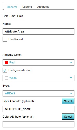

Configuring the overlay
The Right Panel when an attribute overlay is selected.
By default, the overlay does not display any relevant information. The properties of this overlay must be configured first, most notably the attribute based on which to highlight data.
Name
The field for the "name".
The name of the overlay. This is the name that will appear as the title overlay, when hovering over the related icon on the navigation panel. It is also the text in the Overlay legend panel of the overlay as description for the overlay. You can change this by altering the text in the "Name" field.
Attribute Color and Background Color
The fields for the "Attribute Color" and "Background Color".
The colors of the overlay. The "Attribute Color" is the color used to indicate the data with the specified attribute in the 3D Visualization. Note that this will be overwritten if a color attribute is set. The "Background Color" is the color used to color all other areas. You can toggle this on or off with the checkbox. You can change both colors by selecting the color field. A panel will appear in which you can specify the desired color.
Type
The selection dropdown for data type.
The data type which should be checked by the overlay. The type of data you wish to highlight must be explicitly selected. You can change the data type by selecting a different type in the dropdown menu.
Filter Attribute
The attribute which should be highlighted by the overlay.
The attribute which should be present for the data to be highlighted. To select an attribute which already exists, the "Select" option can be used. It is also possible to enter an attribute name yourself.
Color Attribute
The attribute which defines the color to be used to highlight this data.
If set, this attribute is used to determine the color with which to highlight the data. This allows for a more detailed overview of the highlighted data. To select an attribute which already exists, the "Select" option can be used. It is also possible to enter an attribute name yourself.
