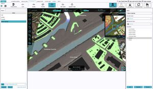

Active function overlay, named "Nature Highlight", configured to highlight green and garden functions.
The Function Overlay is an overlay which is used for indicating where buildings of certain functions exist. When added to a project, it can be activated by selecting the corresponding icon on the navigation panel. When activated, it displays 2 colors. One color indicates where the specified buildings exist, the other color is used for all other areas.

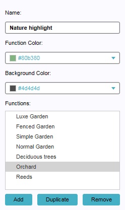

The Right Panel when a Function Overlay is selected.
By default, the overlay does not display any relevant information. The properties of this overlay must be configured first, most notably the list of functions to highlight.
Name
The field for the "name".
The name of the overlay. This is the name that will appear as the title overlay, when hovering over the related icon on the navigation panel. It is also the text in the Overlay legend panel of the overlay as description for the "Function Color". You can change this by altering the text in the "Name" field.
Function and Background Color
The fields for the "Function Color" and "Background Color".
The colors of the overlay. The "Function Color" is the color used to indicate the buildings with the specified functions in the 3D Visualization. The "Background Color" is the color used to color all other areas. You can change this selecting the color field. A panel will appear in which you can specify the desired color.
Functions
The list of functions which the overlay should highlight.
The functions which this overlay should highlight. Any function not in this list is not highlighted by the overlay. To add a function to the list, select "Add", and select the desired function in the function selection window. To remove a function from the list, select the function you wish to remove from the list, and select "Remove".
