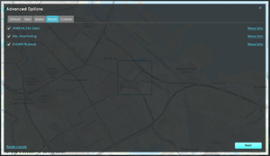

The Roads tab of advanced (geo) options show when selection an area for a new project.
This Traffic Plugin is active when one or more of these source is active as a Geo Option :

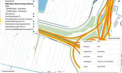

In general, the Road's geoplugin for generated projects situated in the Netherlands, use the BGT or Top10NL to place road geometries. The NWB source is used to add the NWB ID to these roads, such that it can be used for matching traffic intensities.
The NWB id, listed as wvk_id, of a road near the city of Utrecht .

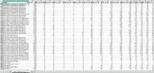

The Inweva excel showing multiple NWB-ids with corresponding hourly work day traffic intensities.
The INWEVA Excel[1] is provided by an infrastructure department of the Dutch government. It contains year average hourly traffic intensities for work and weekdays per traffic group: Cars, Vans and Trucks. In the Tygron Platform the workday traffic intensities are matched to roads. Information from the INWEVA Excel can be matched to roads using the NWB id.

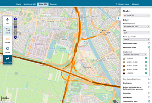

The NSL shown in their viewer. It contains traffic intensity information of the most important road sections per jurisdiction.
The NWB can provide year-average hourly traffic intensities for work or week days. However, it only contains information on the most prominent roads. Information from the NSL can be matched to roads from the BGT and Top10NL, using the NWB id. When a match is found, the daily traffic intensities are converted to an hourly value in the following way:
