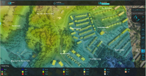

Example of the DSM Overlay
The Digital Surface Model (DSM) Overlay is a Grid Overlay that displays the elevation model, the height of the terrain plus the building height. The Overlay is available to all Stakeholders when added to a project.

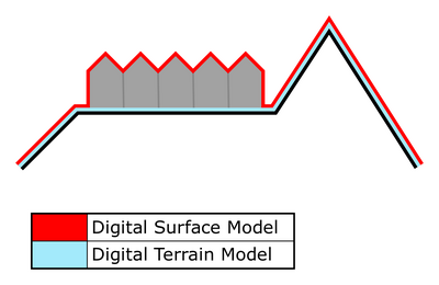

There exist two Heightmap Overlay types:
  • Digital Terrain Model type: displays the height of the terrain at the selected location on the map.
  • Digital Surface Model type: displays the height of the terrain and the height of the building that is located on the selected location on the map.

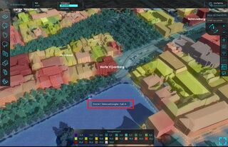

Digital Surface Model: Hover panel displays additional information about the height of the terrain and the building that is located on it
When clicking on a specific location on the map, the hover panel displays additional information about the height of the terrain and the building that is located on that specific location.
