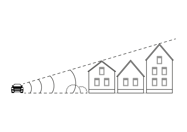

Traffic noise formula (Traffic Noise Overlay)
The calculations for the Traffic Noise Overlay follow the standard rekenmethode 1 (SRM 1)[1].
LAeq=E+Co+CrDaDlDbDm
Dl=0.01d0.9
Dm=max(0.0,3.5(1.0e0.04dhs+0.75+hc+0.75))
where:
LAeq = equivalent noise level (dB(A))
E = calculated emission
Co = acceleration term on intersections (default = 0 dB(A))
Cr = reflection term. This term is not used, and by default 0 dB.
Da = distance reduction
Dl = air reduction (default = XXX dB(A))
Db = surface reduction. This term is not used, and by default 0 dB.
Dm = calculated meteorological reduction
d = distance from the receiver to the source.
e = Euler's number, approximated as 2.7182.
hs = Building datum height (DTM) of the noise source
hc = Building datum height (DTM) of the noise receiving cell.
Default values are taken from InfoMil [1]
