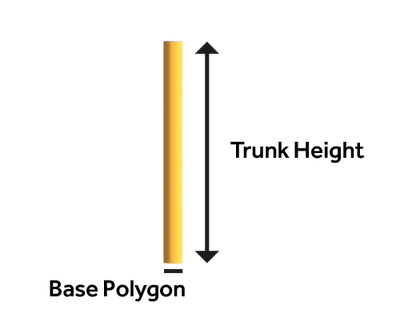

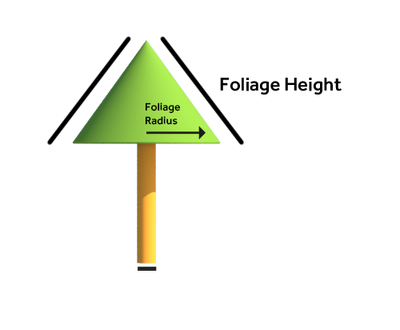

- For each grid cell with foliage, the foliage diameter is calculated by multiplying the height of the foliage building with the foliage crown factor. Dividing the diameter by 2 yields the radius.
- This radius and foliage height is stored for each grid cell.

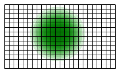

- For each grid cell i, each surrounding cell j within a search range of 100 meters is checked for a foliage height.
- In case the foliage height > 0, and the grid cell i is within range of the foliage diameter of cell j, the calculated foliage height for cell i is based on the distance from the center of the tree and a linear declining foliage height. The linear decline is 1:1 and currently cannot be set to a different decline. See the image below.
- The maximum foliage height is eventually stored as the foliage height of that cell.
