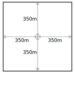

The wind speed and direction are used to determine the window for averaging values around a cell. Commonly, the values at a reference weather station are used. In calculations with a low wind speed, an cell-centered averaging window is used. In calculations with a high wind speed, an oblong rectangle is used for averaging, with the cell in question offset towards the far side along the line of the wind direction.
Wind speed:
  • < 1.5 meter per second, the window is square and cell centered

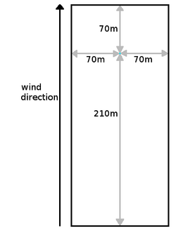

  • >= 1.5 meter per second, the window is oblong, and offset towards the wind direction, to account for the effect the wind has on factors which influence temperature.
The averaging
Window Model Low wind speeds High wind speeds
Large window
700x700 meters, cell-centered

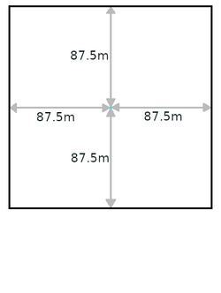

Small window
175x175 meters, cell-centered
280x140 meters, centered at 210x70x70x70
