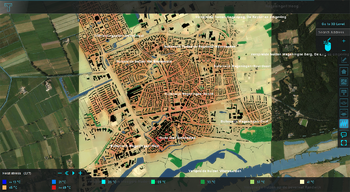

Pet result type (Heat Overlay)
| Icon | Result type | Unit | Mode | Description |
PET | °C | Date-Time | The calculated physiological equivalent temperature. |
The physiological equivalent temperature is a value which expresses the effective outdoor temperature of a (complex) outdoor situation as an equivalent (simple) indoor situation. The equivalence is determined as the point where the heat balance of the human body is balanced with the surrounding environment. In other words, the PET of any given situation outdoors is equal to the temperature indoors at which the human body would gain or lose the same amount of heat.
