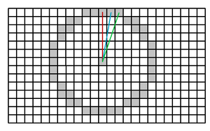

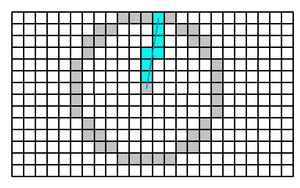

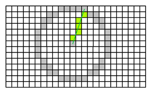

The area of a sky view section is calculated as followed: First the top down view is considered. To determinee the amount of rays that will be cast, the following scheme is applied: A unique ray is cast for each gray cell. Each gray cell also functions as a unique ray end point. The colored cells indicate the cells visited for a particular ray. Each cell has a height of a building, terrain or foliage. The maximum search range is currently 100 meters.

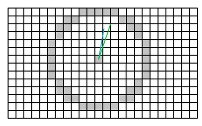

The sky view sections are formed by each consecutive pair of rays. The greater the search radius, the more cells compose the circle, and thus the more rays are cast. Similarly, the smaller the grid cell size, the more cells compose the circle, and the more rays are cast.
For each ray, the maximum view angle is determined by traveling from the center along the ray and reevaluating the view angle based on the building, foliage and terrain height. Next, once the maximum view angle is determined, the ray can be projected onto the horizontal plane.

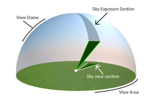

The section of the sky that is visible from any given location is projected onto a 2D plane. This projection is the sky view section.

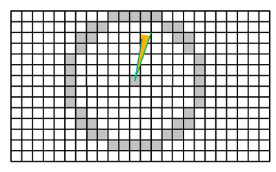

A sky view section is formed by determining the average length of two consecutive rays, and drawing the arc between them using the averaged length.
The average projected ray length from these two rays r1 and r2 are used to calculate the area of sky view section i:
α=arccos(xr1xr2+yr1yr2)
ravg=r1+r22
areai=α2ππ(ravg)2

In literature, two sky parameters are mentioned which is sometimes confusing; Sky exposure and sky view factor. The sky exposure is related to the sky view dome (3D). The sky view factor is related to the projection of the view dome to the horizontal plane (2D).
The Tygron Platform uses the sky view factor rather than sky exposue, because the sky view factor result weights objects closer to the top of the sky view dome higher than objects further away. This is caused by the projection from 3D to 2D. This is desirable, because the sky view factor is directly related to the reflected radiation in the used formulas.
