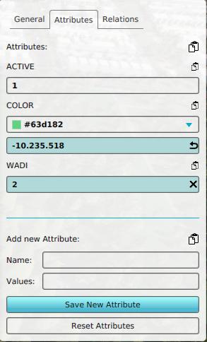

How-to's
The right panel allows you to add new attributes. The top half allows you to edit existing attributes, the bottom half allows you to add new attributes.
