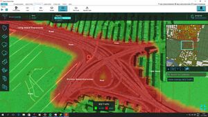

Traffic NO2 Overlay
The Traffic NO2 Overlay is a Grid Overlay which computes the impact of traffic air pollution (in μg/m³ NO2) for any given location in the project. The calculation takes into account the amount of traffic per type and the distance from the source of emission. It also takes into account objects and terrain features which would hinder the travel of particles.
The Overlay only takes into account NO2 emissions from traffic. Other sources of emissions (such as air traffic of factories) are explicitly excluded.
The Overlay implements SRM1[1], which is only applicable for urban environments.
