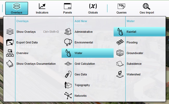

First, ensure a Rainfall Overlay is present in the Project.
Editor → Current Situation (Ribbon tab) → Overlays (Ribbon bar) → Water (Dropdown) → Rainfall Overlay
Adding a Water Overlay.

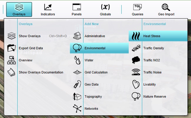

Next, ensure a Heat Stress Overlay is present in the Project.
Editor → Current Situation (Ribbon tab) → Overlays (Ribbon bar) → Environmental (Dropdown) → Heat Overlay
Adding a Heat Overlay.

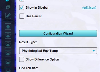

In addition to a Heat Stress Overlay's default PE Temperature result, a shade result can be output as well, which will be useful in demonstrating specific query structures.
After adding the Heat Stress Overlay, it will have been selected in the Editor, and its details are opened in the right panel.
Click on "Configuration Wizard" to open the Heat Overlay Configuration Wizard.
The configuration wizard can be opened from the right panel.
Continue to the step regarding "Output Overlays".
Ensure that, in addition to the default PE Temperature result, the Shade result type is selected as well.
Activate the Shade result type by checking its checkbox.
Close the Heat Overlay Configuration Wizard

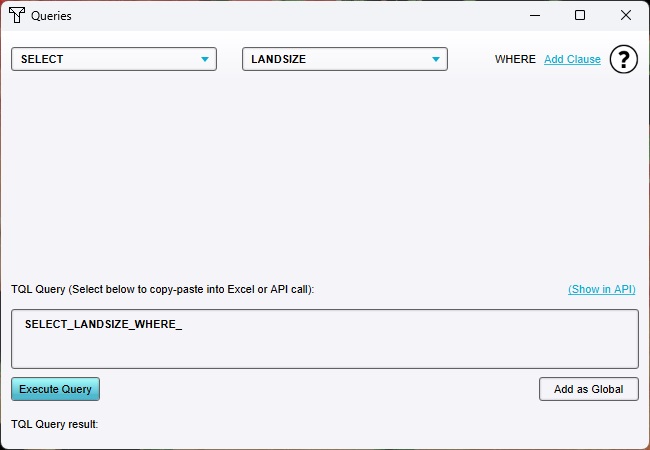

The query tool is an assistive tool for the creation of queries. It helps by offering up options for which clauses can be added to statements and queries. It also allows for executing queries and seeing the results. This means that any created queries can be validated that they function as expected, but also that small bits of information can be requested on-the-fly.
When the query tool opens, a simple query is already composed.
When the query tool is opened a default query is configured.
If any clauses are listed, click on "Remove clause" for each of them until no clauses remain. Only the statement should remain.
All clauses have been removed.
Ensure the query type is set to "SELECT", which means to request data from the Project.
Ensure the statement is set to "LANDSIZE", which is a request for surface area.
"SELECT" and "LANDSIZE" selected for the query.

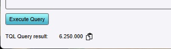

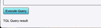

Click on "Execute Query".
Execute the query to actually run it and see the results.
The result shown is the surface area found in the Project, unqualified. It will be the size of the Project in its entirety. Although presented without a unit, it is a surface area, and thus the appropriate SI unit is square meters.
The result of the query.

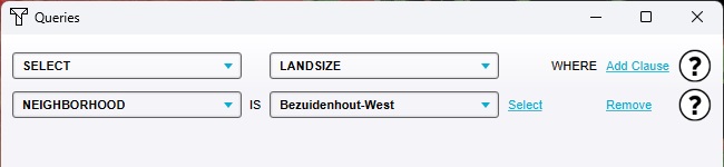

Next, click on "Add clause". This adds a qualifier to the query; a filter or rule the data must conform to before being taken into consideration.
Clauses can be added freely.
Set the clause to "NEIGHBORHOOD", and select a Neighborhood which is well present in the Project.
The query now has a clause associated with it.
The query now has a statement to request the landsize of the Project area, but a clause that it must be land in a specific Neighborhood. In short, the query is now a request for the surface area of a specific Neighborhood.
Then, click on "Execute Query" again.
The result shown is the surface area which lies in the selected Neighborhood.
The surface area of the specified Neighborhood.

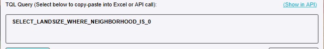

Note that the composed query is shown in the query tool in text form as well. The dropdowns allow for (and guide) the selection of the individual parts of the query, but the full query is all components strung together. The order of the clauses does not matter.
The actual constructed query.
Whenever a query is used outside the context of the query tool itself, it is this text which is used and interpreted.
Also note that using the dropdown, a Neighborhood could be selected by name, but in the actual query the ID of the Neighborhood is used. If the name of the Neighborhood (or any other Item being queried) is ever changed, the ID remains unchanged and thus the query will remain functional.

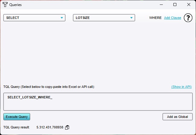

SELECT_LOTSIZE
The amount of surface area which is taken up by Buildings such as apartments, roads, parks and trees. It's effectively the footprint of all constructions.
Create and execute the following query:
SELECT_LOTSIZE_WHERE_
The result is the surface area within the Project area which is taken up by Buildings.
Query for the lotsize, or footprint of Buildings.

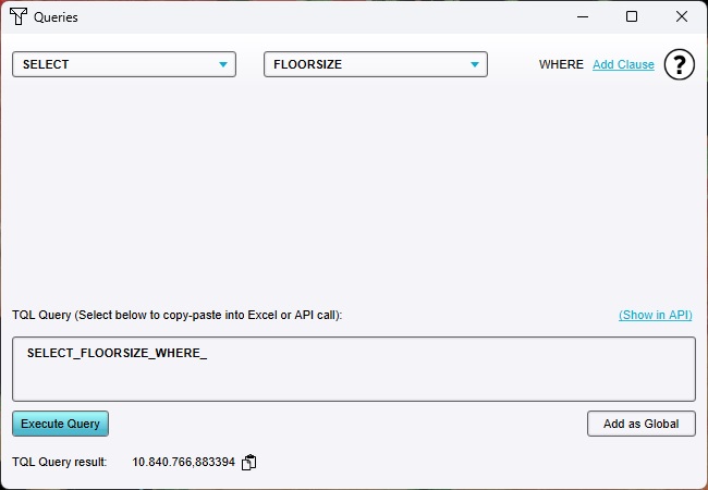

SELECT_FLOORSIZE
The footprint of constructions, multiplied by their respective floors. The amount of space which the found constructions contain for use. This includes "single floor" constructions like roads and trees, unless further qualified.
SELECT_FLOORSIZE_WHERE_
The result is the total floorsize of all Buildings in the Project area.
Query for the floorsize of Buildings.

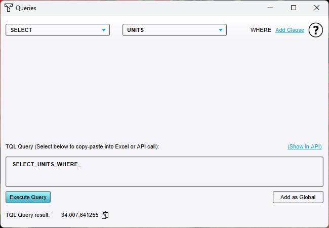

SELECT_UNITS
The amount of housing units present. This is calculated by dividing the floorspace of Buildings by their respective UNIT_SIZE Attributes. Buildings which are not representative of housing are ignored.
SELECT_UNITS_WHERE_
The result is the total amount of housing units in the Project area. Note that this may include a fractional housing unit, as it is calculated based on the known/computable floor sizes.
Query for the amount of housing units.

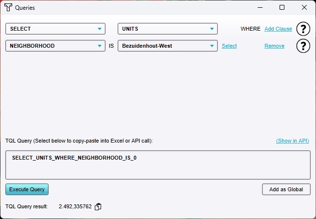

SELECT_UNITS_WHERE_NEIGHBORHOOD_IS_...
The result is the total amount of housing units in the specified Neighborhood. Note that this may include a fractional housing unit, as it is calculated based on the known/computable floor sizes.
Query for the amount of housing units within a specific Neighborhood.

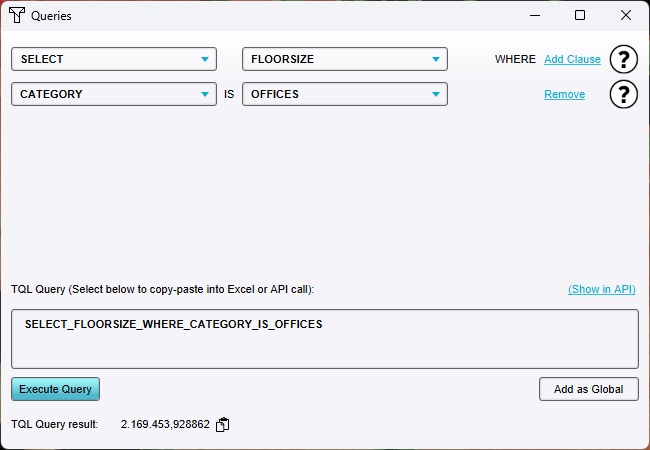

SELECT_FLOORSIZE_WHERE_CATEGORY_IS_OFFICES
The result is the amount of office space in the Project area.
Query for the amount floorspace of offices.

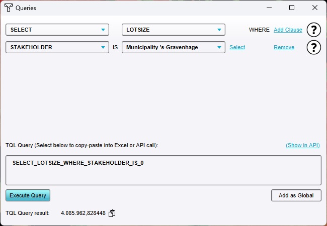

Create and execute the following query, with the Municipal Stakeholder selected for the STAKEHOLDER clause:
SELECT_LOTSIZE_WHERE_STAKEHOLDER_IS...
The result is the amount of built surface area which is owned by the Municipality.
Query for the footprint of buildings owned by the municipal Stakeholder.

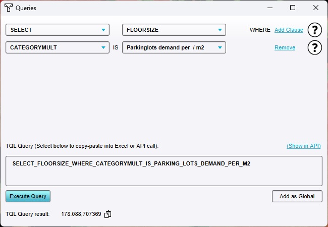

SELECT_FLOORSIZE_WHERE_CATEGORYMULT_IS_PARKING_LOTS_DEMAND_PER_M2
The result is the amount of parking spots which are required to meet the parking demand of all Buildings in the Project area. This is calculated by obtaining all the floorsize of all Buildings, and then multiplying it by the respective parking demand for all Buildings.
Query for the demand for parking lots, by obtaining the floorsize of all Buildings and multiplying it by the respective parking demand factors.

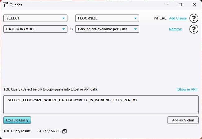

SELECT_FLOORSIZE_WHERE_CATEGORYMULT_IS_PARKING_LOTS_PER_M2
The result is the amount of parking spots which are available in the Project area. This is calculated by obtaining all the floorsize of all Buildings, and then multiplying it by the respective parking supply for all Buildings.
Query for the available parking lots, by obtaining the floorsize of all Buildings and multiplying it by the respective parking availability factors.

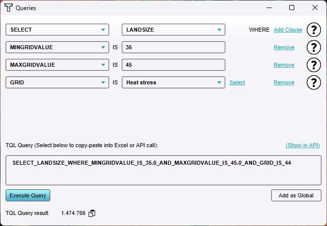

WHERE_MINGRIDVALUE_IS_...
Consulting only grid cells the value of which is at least the specified value. (Inclusive, so a cell with the exact value is included.)
WHERE_MAXGRIDVALUE_IS_...
Consulting only grid cells the value of which is at most the specified value. (Exclusive, so a cell with the exact value is excluded.)
Create and execute the following query, with the Heat Stress Overlay's PE Temperature selected for the GRID clause:
SELECT_LANDSIZE_WHERE_MINGRIDVALUE_IS_35.0_AND_MAXGRIDVALUE_IS_45.0_AND_GRID_IS_...
The result is the surface area in the Project area which has calculated temperatures in the range of 35°C to 45°C.
Query for landsize which, according to the Heat Stress Overlay, has temperatures in a range of 35 to 45.

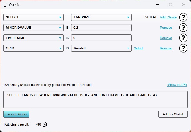

WHERE_TIMEFRAME_IS_...
The Timeframe of the grid to use. When absent, the last Timeframe of the Grid Overlay is used.
Create and execute the following query, with the Water Overlay selected for the GRID clause:
SELECT_LANDSIZE_WHERE_MINGRIDVALUE_IS_0.2_AND_TIMEFRAME_IS_0_AND_GRID_IS_...
The result is the surface area in the Project area which has at least 20 cm (0.2 meters) of water on it at the first recorded timeframe (timeframe 0) of the Water Overlay's calculation.
Query for the landsize which according to timeframe 0 of the Water Overlay has at least 0.2 meters of water.

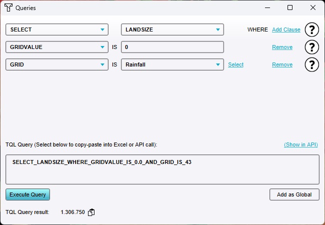

SELECT_LANDSIZE_WHERE_GRIDVALUE_IS_0.0_AND_GRID_IS_...
The result is the surface area in the Project area which, at the end of the Water Overlay's calculation, has no water on it.
Query for the landsize which according to the Water Overlay has 0 meters of water on it, implicitly in the last timeframe.

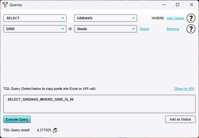

SELECT_GRIDAVG
The average value of grid values.
The grid average is calculated by taking all values in grid cells across the entire indicated region, and averaging them. Due to the uniform nature of grid cells, the average of those values is the same no matter if its considered in relation to a count of grid cells or to a count of surface area.
SELECT_GRIDAVG_WHERE_GRID_IS_...
The result is the average temperature in the Project area.
Query for the average temperature as calculated by the Heat Stress Overlay.

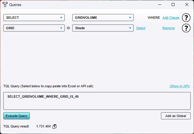

SELECT_GRIDVOLUME
The volume of grid values. The surface area of each individual grid cell, multiplied by its respective value.
The grid volume is calculated by taking all values in grid cells across the entire indicated region, and adding them together to a total. The result takes into account the size of grid cells. In other words, the volume returned for a single cell is the surface area of the cell multiplied by the value of the cell. If the value of the cell is (also) in meters (m), the result for the volume of a single cell is in cubic meters (m³).

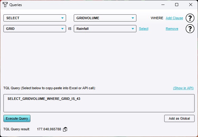

SELECT_GRIDVOLUME_WHERE_GRID_IS_...
The result is the volume of water in the Project area.
Query for the volume of all cell's results, as calculated by the Water Overlay, added together.

Create and execute the following query, with the Heat Stress Overlay's Shade Coverage selected for the GRID clause:
The result is the average value of shade coverage in the Project area.
The average value of the cells in the Project area, as calculated by the Shade result of the Heat Stress Overlay.
However, because all the values in the Grid Overlay are only a 1 or a 0, the result can also be read as the fraction of Project area which has shade coverage.
The result is the "volume" of shade coverage in the Project area.
The volume of the cells in the Project area, as calculated by the Shade result of the Heat Stress Overlay.
However, because all the values in the Grid Overlay are only a 1 or a 0, the value as read as a volume can equally be read as a surface area. (Because all surface area which should be taken into account is multiplied by "1", leaving the value unchanged) Therefore, the result can also be read as the surface area which has shade coverage.

A practical example is that the amount of actual land can be obtained using the following queries, and subtracting the results from one another:
SELECT_LANDSIZE_WHERE_TERRAIN_WITH_ATTRIBUTE_IS_WATER
By subtracting all surface area which is a Water Terrain from the total surface area, what remains is all the surface area which is not water.
